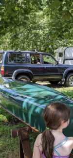

Howdy. I picked this canoe up a week or so ago from a barn sale for a price I couldn't refuse. The wood appears solid although incredibly dry and after some white water web surfing, I determined that Watco exterior oil is a good option for this (if this is not a good idea, let me know!). Following the instructions on Mad River's site, I taped off the shiny bits and began gently sanding with 80 grit paper. Between the outer edge and the inner edge (gunwale and inwale) there appears to be a gap. Before I oil it, should something be in the gap or will the wood expand when it's hydrated?
Couple of quick pictures, it was disgusting when I brought it home. Covered in bird crap and barn dust. My trusty helper was up to the task of scrubbing it down prior to sanding.Screenshot_20220820-155510.pngPXL_20220820_192026503.jpgPXL_20220820_192717285.MP.jpgthe gap.PXL_20220820_193933733.jpg
Looks like a Kevlar Explorer. There is often a little gap between the inwales and the outwales. MRC used kerfed outwales on that boat so there is a little lip that extends over and hides (mostly) the top of the hull. The hull thickness sometimes varies a bit along its length and sometimes the kerf doesn't quite meet the inwale.
Give the wood a good sanding and then oil it, if that is the treatment you plan to use. You can also go ahead and make sure all the guwale screws are as tight as you can get them.

Thanks for the reassurance.
Would it make more sense to tighten the screws up after being oiled? Seems the wood would be a bit more flexible and less prone to cracking?
Fantastic! Watco Exterior oil is what Northstar uses and sells; it is frequently recommended in canoe fora.

Won't make any difference. Despite all the hoopla about "penetrating oils" these are pretty much surface treatments. the oils will penetrate some along grain lines but not significantly into the dense wood. I have whitewater canoes with wood gunwales that I oil. I tend to slide the heel of my hand along the gunwale for some strokes such as stern pries. After one downriver trip of 5-8 miles the oil is completely wiped off that section of the gunwale with smooth bare wood showing. The oil won't get anywhere near any of the wood that the screw tension impacts.
Congrats on a nice find. The bird crap and dust must have preserved it well- it looked better than the one I bought in New Mexico a few years ago before you started on it. Mine had some kind of dry rot on the surface of the gunwhales and took a lot of sanding to get to the condition of yours. It may be the light, but it looks like the oil is wet in the last photos. The Watco instructions say to wipe it off with a dry cloth after the second coat so that it doesn’t get tacky. BTW- nice Cruiser. Mine came home on top of one also.

Yes, I almost mentioned the same thing. It is important to wipe the excess Watco oil off after you allow it to penetrate for 15-30 minutes otherwise it can form a gummy residue that has to be scraped off. I have used a lot of Watco oil although I usually use their Teak Oil these days rather than the exterior Watco. I have found that with Watco oils you can usually apply at most three coats per day. Any more and the oil will just sit on the surface.

Regarding the oil, it was wiped off after 30 minutes from first application and 15 minutes after the 2nd. It's a nice satin sheen as we speak. I was just excited at how nicely the wood came to life once the oil was applied.
