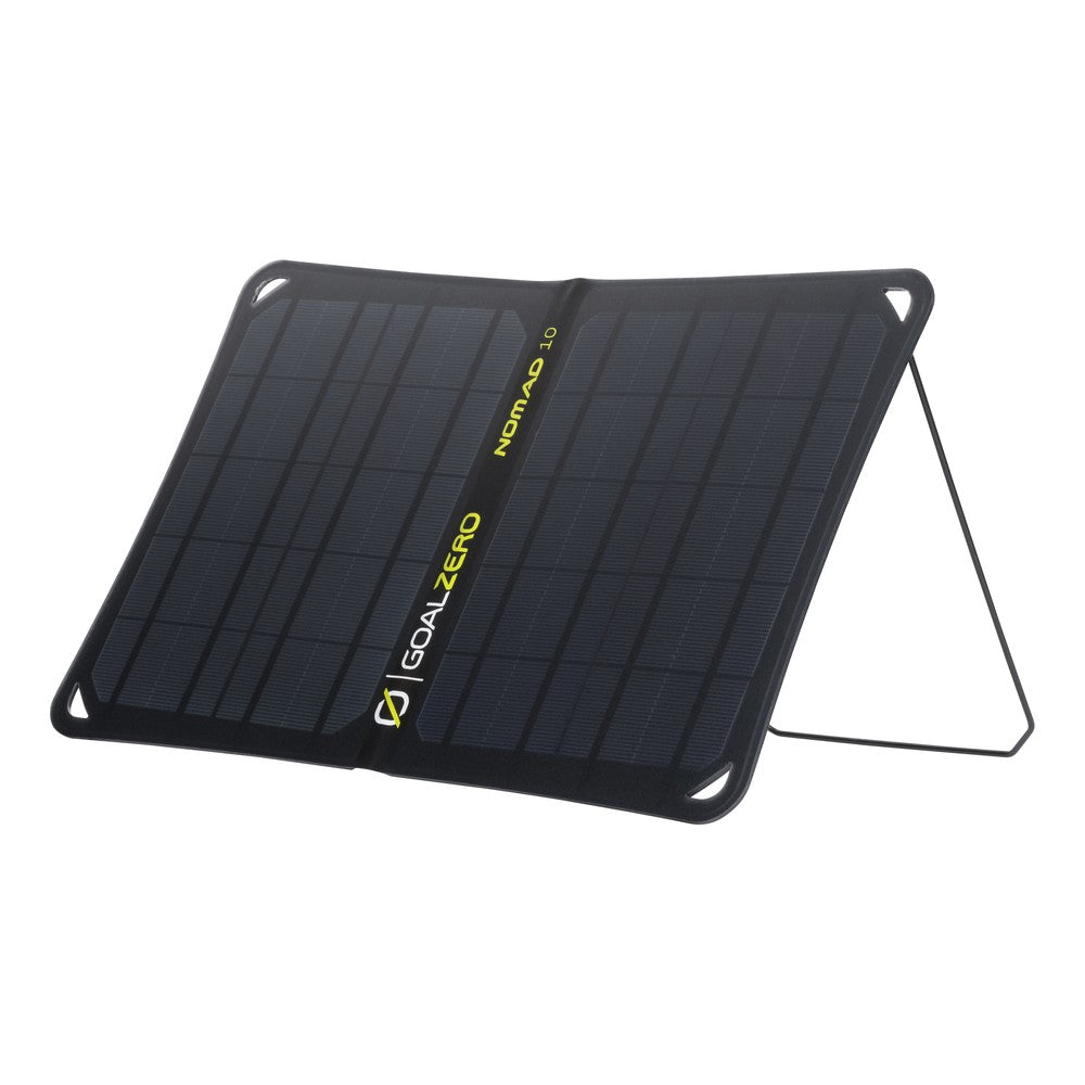

I definitely wouldn't want less than the ten-watt, and would probably go with the Nomad 20 if I were going to do it again. The Nomad 5 is about useless, IMO.
The Nomad 10 and a 20k milliamp-hour MyCharge waterproof power bank have ensured that I've had practically perpetual power for the devices I carry.
