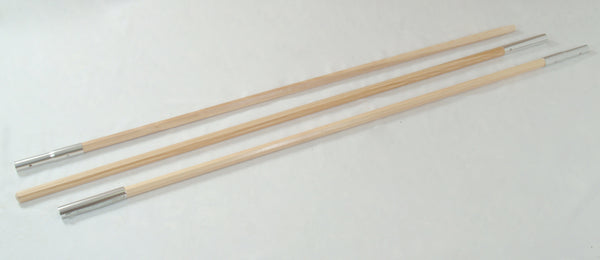

I'd like to get a two-piece wooden pole. No, I don't want a one-piece pole and, no, I don't want to make one. I know where to buy a two-piece aluminum pole, but I'd rather have wood.
Does anyone know where to buy a two-piece wooden pole or anyone who makes them?

Thanks. I've also found similar tree pruning poles at the following two sites. I wonder if they are all from the same manufacturer.

I noticed hollow fiberglass pruning poles on one of the sites I linked above. They have 6' connectible male and female poles just like the wood ones they sell. The fiberglass poles are significantly lighter than the ash poles. I was wondering what the benefits and detriments of hollow FG would be for my minimal poling requirements. The price is reasonable and the company is less than a two hour drive from me.

I've seen those fiberglass arborist poles but never got to try them out for canoeing. If you go that route, I'll be interested in how they adapt. I had trouble using stainless steel ferrules for poling because they want to over telescope--they aren't made to be continually jammed together. The CF ferrules work better because the tubes butt together. So, pay attention to how well the pieces of the ferrule fit together.
