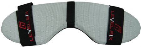

Yeah the black strap yoke pictured above is from Mohawk, I have one in my XL14 that was factory installed. I hate portaging so I generally drag for ports under 200m, longer when the terrain is really bad (ie: swampy with deadfall). That means I only use the strap yoke for long portages (500 - 1000m). On it's own it not very comfortable but with the addition of one of these it's reasonably comfortable.
