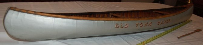

As much as I want to keep it original it won‘t be painted aluminum!
I'd be real curious to see an aluminum color canoe.
It isn't a really attractive color but was popular in the 1940s and 1950s (even before aluminum canoes were invented). The image below shows a four foot model that was painted aluminum.
