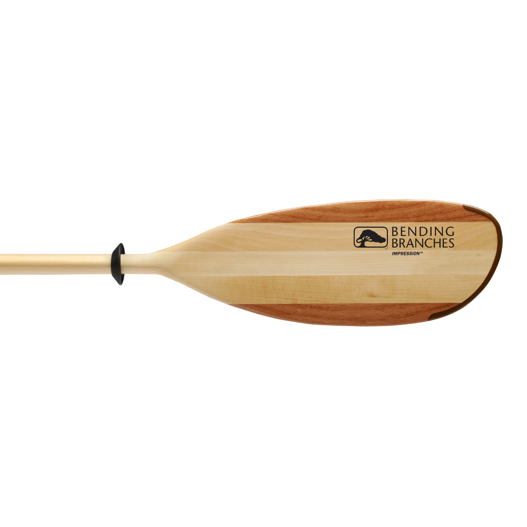

Bending Branches makes a canoe specific double bladed paddle. It comes in 260 and 280. I’ve never used one so I couldn’t say what the difference is.
They work well. I use a 30* cant. The impression is a tad weighty, but I didn’t care back then. Wife paddled a Prism through Woodland Caribou with one. She didn’t seem to mind. I was in an Encounter and feel like the blade width was useful in the big boat.
I checked the BB website and the Impression Solo isn't specifically a canoe paddle. In fact, it doesn't even show up if you use any of the canoe paddle filters, it just shows up among all the single-blade paddles under the "Canoe" heading. But if you look under the "Kayak Fishing" or "Kayak" headings and use one of the filters, there it is, so they consider it a kayak paddle. So if it's 240 cm it's a kayak paddle but if it's 260 cm it suddenly becomes a "double-blade canoe" paddle. To make things even more confusing, if you use their paddle sizing chart, if you're in a canoe under 35" in width and are 5' 5" or under you'll need to buy a "kayak" paddle because they don't sell an Impression Solo "double-blade canoe" paddle in that size. You can buy one, but it's called the Impression kayak paddle. As far as I can tell, the only difference is the range of lengths offered under the "Canoe" vs "Kayak" categories, the blades are identical as shown.

I checked the BB website and the Impression Solo isn't specifically a canoe paddle. In fact, it doesn't even show up if you use any of the canoe paddle filters, it just shows up among all the single-blade paddles. But if you look under the "Kayak Fishing" or "Kayak" headings, there it is. And to make things even more confusing, if you use their paddle sizing chart, if you're in a canoe under 35" in width and are 5' 5" or under you'll need to buy (wait for it) a kayak paddle, only now it's called the Impression paddle. The only difference is the range of lengths offered under the "Canoe" vs "Kayak" categories, the blades are identical as shown.
So I actually found the Impression under Canoe>Solo Canoeing. I thought that was a weird place for it, but I was at work so I didn't have much time to read through everything. Now I'm even more amused that they have identical paddle with two different names for the length.
