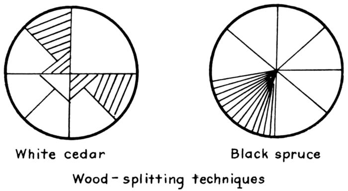

Always amazing to see another birchbark canoe being born. Very cool stuff! Didn't know that birch would steam that well into ribs. Nice to know! Out in Northern Quebec & Labrador, the Cree & Innu would still use spruce for ribs. It would be split differently than cedar but still bend well.
Ha good to know that spruce would work good... I need to find info on the splitting method so Murat, if you have any info please let me know!!
