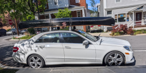

I've bought a new Savage River Illusion canoe, which cost more money than I ever imagined I would spend. To lighten the weight, which was one of my primary objectives in getting the canoe, it's made of Textreme carbon and Kevlar with an outer layer that is a so-called skin coat—i.e., no gelcoat. The resin used in the laminate is all epoxy, which is subject to UV degradation.
I often leave my canoe on top of my vehicle for weeks at a time during the warm season, such as here in Berkeley Springs, West Virginia.
Because I've never had an expensive, skin coat, epoxy canoe among my large lifetime fleet, I'm a bit worried about UV damage for appearance and resale value. I'm therefore thinking about whether a custom travel cover would be a worthwhile investment for when the canoe is on top of a vehicle for several weeks from spring to fall. On the other hand, I wonder whether the UV risk is overblown in my mind for a northeast canoe that's stored indoors when not being cartopped, and which can be coated periodically with a UV inhibitor such as 303 Protectant or marine wax.
Any thoughts, opinions or actual experience with using or not using a travel cover for such a canoe would be appreciated.

I'm actually more worried that the black hull is going to broil in high summer and degrade from overheating.
Another interesting point. I wonder if a canoe cover makes that possibility better, worse or no difference.

I keep my canoe on my car all through summer and fall. It's burgundy red so the paint protects the epoxy from most of the UV. It does not protect the canoe against heating up in the sun which, with epoxy, is not very good either. I have bought thin silvery fabric and will try and sew a cover for it when I get around to it. I think it's worth considering the heat issue though so if you are going for a cover then a brighter color is probably the best way to go. Brighter colors will reflect more UV and will not heat up as much. That black canoe is stunning, but heat and UV could be a problem if you just leave it like that out in the sun for days and weeks on end.

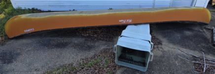

I'm just curious if anyone has ever seen a case of UV degradation from normal use.
I guess that depends on your definition of 'normal use.' There are lots of real disaster canoes that show up for sale after being left outside for years. They often appear later in a Facebook canoe group with someone asking 'how can I fix this?' Two examples that I could find quickly are shown below. (I realize that these aren't epoxy but the issue is similar.)
