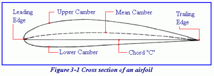

This is an interesting discussion, coming from an aerodynamics background with my first ever homemade paddle roughed out and waiting for my return to the cabin to finish it.
In aircraft wing design, "camber" usually refers to the mean line curvature, which is the average of the upper and lower surface curvature (which are sometimes referred to as the "upper surface camber" and the "lower surface camber"). A symmetrical airfoil (same curvature top and bottom) has zero mean camber; the mean line is a straight line. Airfoils are defined by a thickness distribution (how the thickness varies from front to back, the actual thickness in percent of chord (the length from front to back, typically 10-15%). That thickness distribution is superimposed on the cambered (or straight) mean line to define the upper and lower surfaces.
"Dihedral" is an angle, not a curve, referring to the upwards angle of the wings from the center to the tips, viewed from the front to the tips. I could see it applying to the blade faces if they're flat tapered and not curved.
A cambered airfoil will produce lift (which some attribute to Bernoulli, though it's not a simple as that) unless it's angled nose down to compensate for that, which creates more drag than a symmetrical (uncambered) section producing zero lift. Also if a paddle blade has any mean camber, it will tend to twist when slicing through the water. But there are one sided paddles, no? A cambered blade could be more efficient during the pulling stroke, at the expense of slicing behavior.
