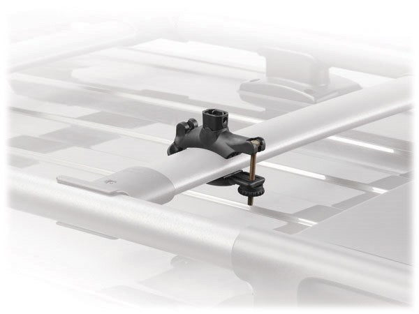

For load stops I recommend Yakima universal mightymounts.
Looks like there may be some newer mightymount options too.
The Yakima gunwale brackets made for Yakima aero bars also work fine on my wife's CRV but without knowing the exact shape of your crossbars the mighty mounts seem like a safer choice. Both shown in pic
