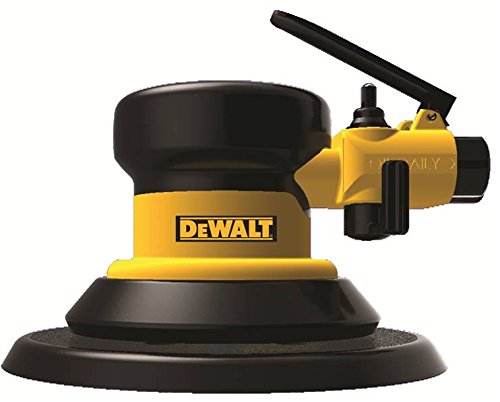

Well, I was in Lowe's yesterday picking up a couple things for work, and happened by the air tool area. Ended up coming home with this. Once I give it a good go, I will report back. Not sure when that will be though. It certainly is small and light, and fits in the hand nicely. It is a 6", and I would have preferred 5".
http://www.lowes.ca/air-sanders-and-polishers/dewalt-dewalt-palm-sander_g2187428.html
