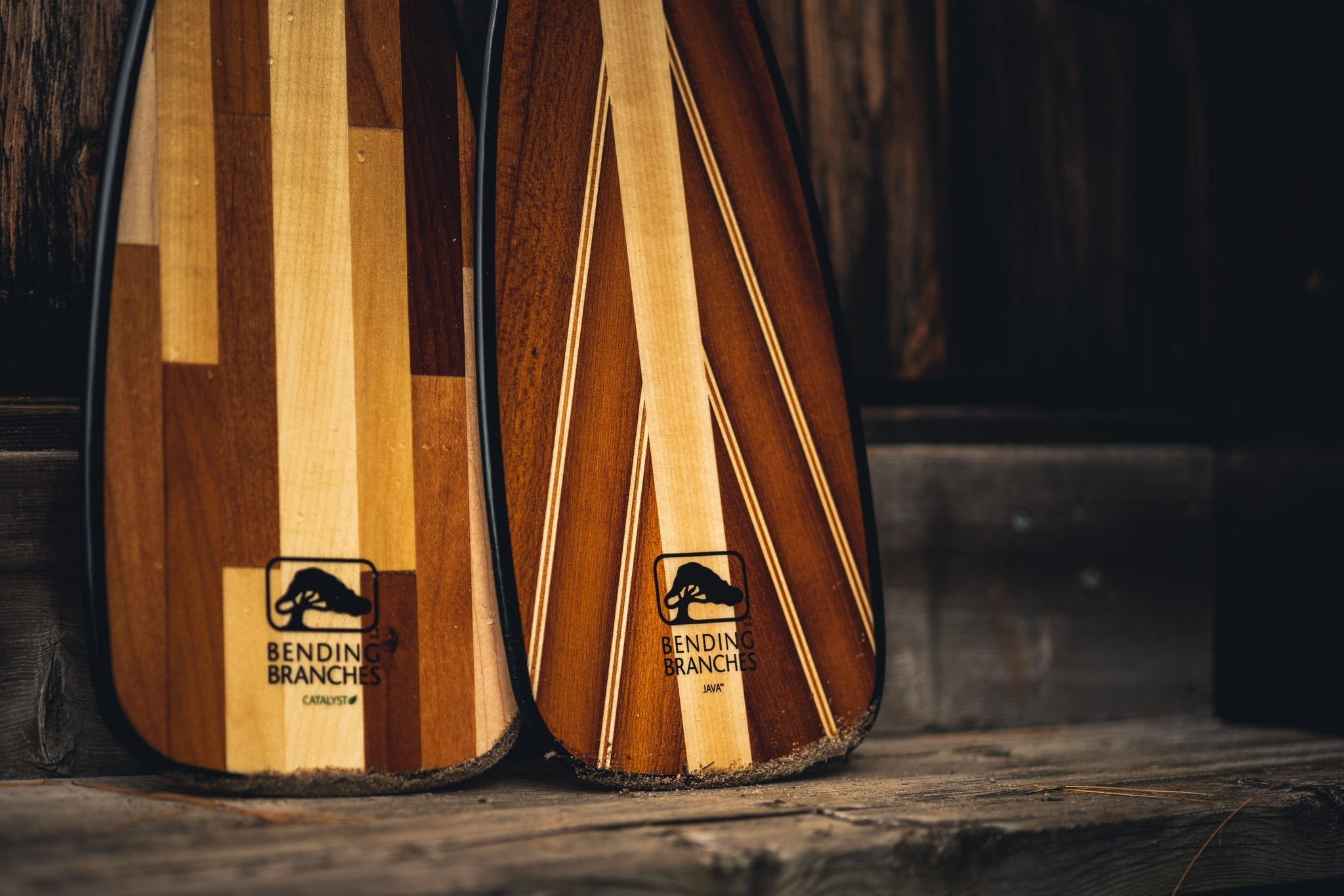

I was looking at the Arrow from Bending Branches. Not sure if is the correct shape for my part of the world, or if there is one more preferable.

Re: the Bending Branches Arrow, pictures show a non-symmetrical grip on a straight shaft paddle, which may feel awkward if you enjoy underwater recoveries that involve spinning the grip in your palm each stroke. The Explorer Plus is a similar shape with some more edge protection and a symmetrical grip, aka ‘freestyle grip’. Before I did the reshape on my old Clement, I was looking at the Java ST because I liked the angled laminations that look like arrow fletching. I’d really love to find a Grey Owl feather paddle!
I am in the just get a paddle and use it camp. The BB Arrow is a perfectly good start. I use a 58" one paddling stern in a Wenonah Adirondack. In a solo boat I use a 56, and I'm about your height. So that's where I'd start.
Thanks for pointing out the grip on the Arrow. I agree with you that the Java ST is the best looking one. I think maybe I am leaning towards that one at the moment (subject to change at any moment).

Haven't used it much yet but so far I like the Java ST paddle, though it may be less sturdy than the other heavier Bending Branches paddles. I hope to avoid testing the limits of its sturdiness.:)
