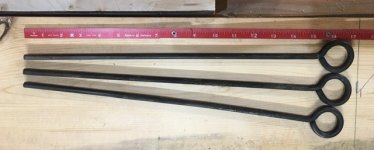

A fiend black smith made me what I call fire spikes... it is 3 piece of round steel rods that have an eye at one end and when place together form a triangle that you place on three rocks and you set your pot on that triangle, the triangle is ajustable w/o moving the rocks so you can use different size pots...

Wow, I like that and REALLY easy to make! Next time I light the forge, I'll have to get me some. Is one shorter than the others or are the rings just large enough to allow them to disengage for transport?
There is a ring only at one end.. I’ll take more pictures today!
My father used two pieces of wall mount for shelving. These "U" shaped bars worked well. I just use firewood, or lash a tripod.

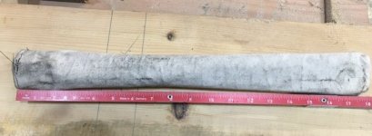

This is the ajustable fire triangle better photos!! Made out of 5/16” round stock...
