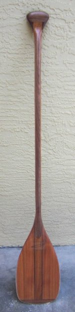

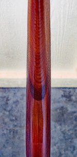

In response to several questions about the edging around my river and shallow water special blades, it is Dynel cord, saturated with epoxy. Dynel is commonly sold as a thin cloth but it is also available as "cord". The material that I use is very much like a very heavy shoe lace, approximately 1/2" wide and 1/4 inch thick, prior to being saturated and compressed. Used in this manner it makes for a highly abrasion and impact resistant edge. Application is a bit tricky as it must be uniformly saturated and compressed. Being as thick as it is, it does not saturate easily.IMG_1540 cr en sml Dynel cord.jpgIMG_1543 cr en sml Dynel cord.jpgIMG_1544.JPG
