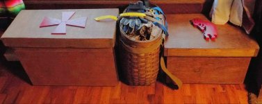

Photo of a couple of wannigans that I made for a paddling buddy.
He strores canoeing/camping gear in them; helps keep gear he always takes consolidated.

I thought about it a lot, but to me it defeat the purpose of a container that is easy to organize(round boots corners would be a pain to have stuff stay when you put them), that is light (cause I think that it would end up heavier than the one I made).... They look good.... But I don't think they are as practical as a "traditional" one!

The way I made mine kind of help with that, I made a raised bottom, the box is made of 1/4" baltic birch ply, so pretty sharp corners, so to have those corners up I made a cedar wooden frame that tis half recess into the bottom, and the corners of that frame are well rounded over and being cedar are quite soft... So far so good!
