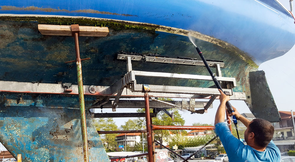

Does this help? It seems you have to scrape and sandblast the entire affected area. Then let it dry for... Two Months? Wow.. That is a big investment of time and money
Knowing nothing about the problem I relied on Mr Google
I’ve seen it many times on 5e big boats I’ve worked on but never a canoe. It must have sat in the water a long time. That is the process, grind them off, probably the whole gelcoat layer and then let it dry for a long time. I wouldn’t gelcoat it again, just use epoxy and paint it. It will be a lot of work that is for sure.
