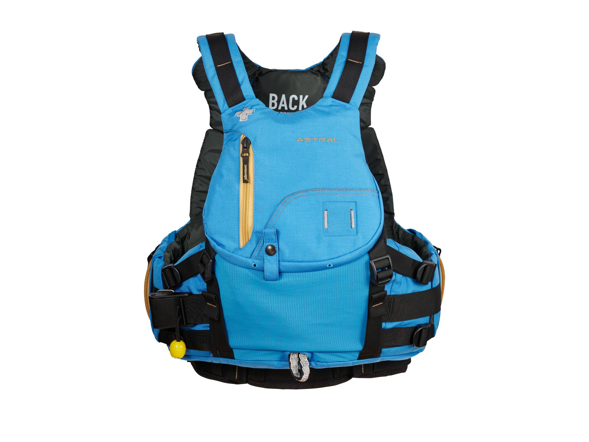

More than I’d want to pay full price for but this came out last year and gets some hype in the WW world. I know a few people who use this regularly and really likes it. Super light, very comfortable, type V and 22lbs of buoyancy.
I’m still using my second Sea Wolf (discontinued) and Ceiba both are class III and roughly 17lbs of float
The Indus is pricy, but it is on my short list. If it is a good fit I may decide to pay a bit more for the safety factor. Or maybe I'll buy two other PFDs for the same price and wear one over the other, giving me 32 lbs. of buoyancy for the same cost. :rolleyes:
Yeah the Indus is a lot of money for a pfd, almost like they’re competing with Kokatat pricing. Personally, I’d have a hard time paying $400 for life jacket even if it is better.

Astral: Indus (22.3 lbs. floatation)

I was also in the stratosphere of PFD pricing when I looked at the remainder of the list and had the top choice not been on sale (1/3 off) I might have been hard pressed to buy it even though it checked all my boxes and had the best fit of any on my list. The price "on sale" came down to “high reasonable” category.
