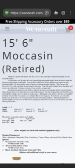

I see one for sale here cheap. Possibly a fixer-upper. Haven't had a look at it yet, but I wonder if it's worth my time.
I'm unfamiliar with that model. I looked it up and it seems like an odd boat. It's built specifically for kneeling but has apparently no rocker and is not meant for big water. Sounds similar to the Whisper except for the seating arrangement.
I don't know how cheap you mean by cheap but if it truly is cheap it might be a cheap way to have some fun in a unique canoe.
If it was mine I'd set it up for sitting and use it as a quick day paddler.
I had a 1999 Moccasin in Kevlar Flexcore for a while. Kruger design, but mine was ordered with the Wenonah sliding bucket. It was pretty quick and narrower than most of Wenonah solos. One of the canoes I regret selling, but too heavy for me in that layup with gelcoat. Definitely worth your time.
Okay, it needs a little work, but for $175? Why are you still here!
