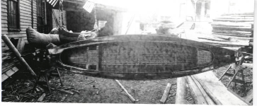

Related to seam lines, Harold Deal told me in person many times that he first got the idea for shouldered tumblehome from looking at partially decked Rushton canoes in photographs and museums, such as the two below. This first Rushton canoe (~1908) has a flared hull that, at the seam between hull and deck, "tumbles" the cockpit gunwales inward at an up-sloped angle.
Here's another ~1908 Rushton with a much fuller deck, but the feature of tumbling of the cockpit/gunwales upward and inward alongside the paddling station is conceptually the same.

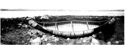

While limited by the bending methods of bark and ribs, you can see that the Eastern Cree pulled in ("tumbled") the gunwale tops of their so-called "crooked canoe" hulls. (Adney & Chapelle, p. 101)
In today's Yost-influenced terminology, we'd probably say the Cree crooked canoe has bubble-sided tumblehome.
