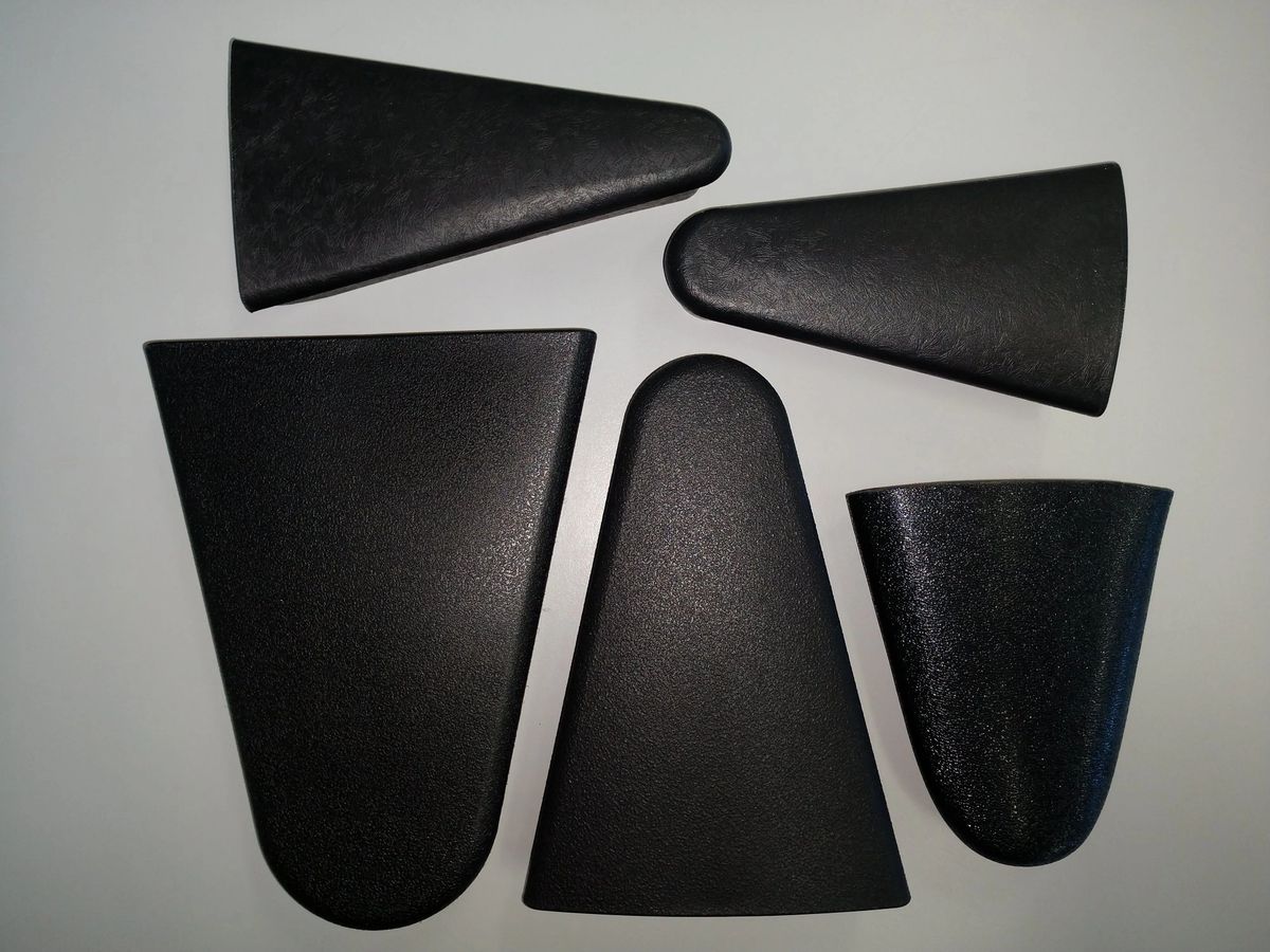

Plastic end caps (decks) of various sizes can be found for sale on the web if you search. For example, here:

Are the wrinkles that happened on the sides a problem? Does it make a weak spot or is it similar to a dent in an aluminum canoe? As far as the deck it is pretty much shattered.
