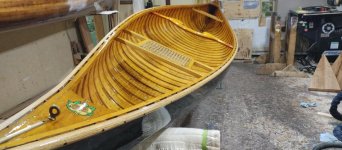

I recently acquired a Peterborough Minetta.
Some scraps of cloth and contact cement.
A bit of paint and some screws and she is floating.
I’m preparing to order some canvas and some wood to replace a few ribs and a little planking, but for the most part it’s in really nice shape so should not take to long to get ready for the new canvas. It’s a pretty hull and is a dream to paddle.
There were cracks drips and runs throughout both layers of paint. The green and the red.
The canvas was completely rotten under the gunnel, some gorilla tape along with the glued on patches seems to be holding for now.
I am older than I used to be, and will likely treat this more like my Blackhawk than my Dagger, so am considering using a #12 canvas and possibly a water based filler to save some weight. Odds are I’ll use traditional filler since that is all I have experience with, but I am curious about newer/ faster/ lighter methods. IMG_9580.jpegIMG_9583.jpegIMG_9655.jpeg

The Bow seat is split so that came out.
The center thwart didn’t seem to be original so that is out, and I carved a carrying yoke to replace it. A new thwart was hung at both seat locations to help it maintain its shape and stiffness.
I paddle kneeling for the most part and can sit on a bag to give my knees and ankles a break when necessary so no seats will be put back in, although a kneeling thwart is a possibility.
I may make a folding wood seat to put in the front for times when my wife or daughter might join me. It should be stable enough with a passenger on the floor for a short lake / calm river tour.

Ok. It was in worse shape than I expected. But I should not be surprised.
I put in a temporary wider center thwart to allow the hull to relax to its design shape, 29” was a bit short and tender for standing up and poling (it’s ok. I like swimming) but at 33” it should feel better. A lot of this isn’t original, or is rotten and it’s a common hull so I feel ok modifying things.
So no I’m left with choices. After the stems are spliced and the decks replaced I need to make decisions so I’m throwing out my uses and desires to solicit comments and ideas.
I’ll be solo 99% of the time.
I will mostly paddle lakes and easy rivers. I pack light for camping, and trips will mostly be short, a week or less. I fish a little. I enjoy standing up. I don’t expect this to be as stable as my old dagger reflection but will be more than my Blackhawk shadow 13 when standing to pole paddle or cast ( yep, went swimming occasionally! lol).
I also used to row a little Adirondack Guide Boat a lot. And still have my Shaw and Tenney oars so the idea of a removable drop-in seat and clamp-on thwart with oar locks is interesting, but low priority.
So now I’m sketching up layout ideas.
I mostly kneel and paddle on one side, like to sit when fishing, I like to pole upstream and paddle down when on rivers. I think the original layout will work, but am considering different options.
