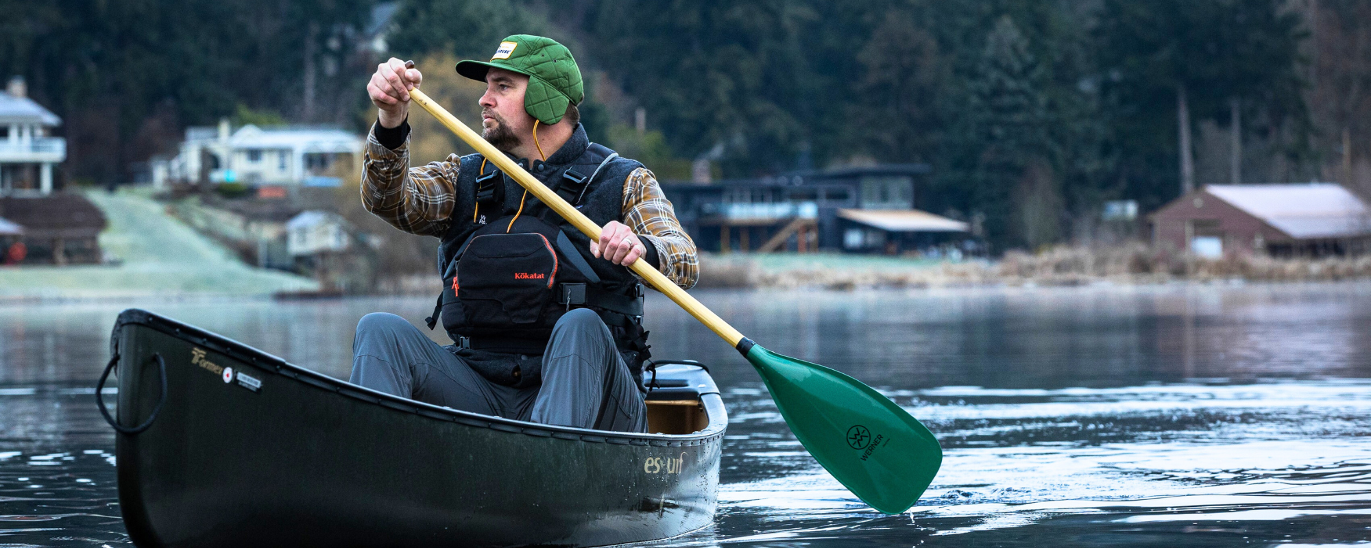

I keep seeing photos of people with super long paddle shafts and they are gripping the shaft in about the middle.
Like the guy in the photo at the top of this page (I hope).
I've read many, many articles on finding your correct paddle length and I have never seen one that recommends a super long shaft gripped in the middle, yet I see it all the time. I size my paddles so that when the blade is submerged to the throat, the top of the grip is at about eye level. I might add another four inches or so for white water, but not a foot or two and I don't grip the shaft 20 inches above the blade.
What's going on?
That guys paddle does look long but I don't think his lower hand is where it would be for normal paddling. There are many situations that you move your lower hand up to increase reach and leverage. I think this is common in free style paddling.
My perfect paddle length is about 57" or 58" but I use a 60" because I solo big boats on typically windy lakes. My spare is 72" and originally I brought it for standing but I also use it in a strong wind. I doubt the guy in the photo is using a very long paddle like the 72".
What's going on?
While there are occasions to choke up the lower hand on the paddle shaft, such as to get more paddle extension for certain flat water freestyle turning maneuvers or for a sweep stroke, I agree the paddler in this photo has a paddle much longer than I would use for flatwater.
He seems to be in very shallow water so is likely trying to paddle with only a partially submerged blade. His choices to do that are to hold that paddle with his his grip hand high in the air or to angle the paddle outward. He also may be trying to do a sweep stroke turn at the same time. In any event, I wouldn't use a paddle that long.

The guy in the photo is using what's called a "tall grass paddle." It's a specialized paddle designed so the tall grass doesn't tickle your fingers.;)

Some of that grass will do more than tickle. Good point.
