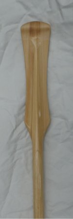

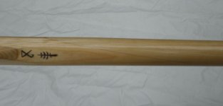

Late last year, I snapped my favorite paddle in two. No rocks were involved - it was all just me and the current. That really was a lightweight paddle. Carbon reinforced laminated cedar. It was a jagged break, but mostly clean.
So a few weeks ago, I glued it back together with polyurethane glue. Managed to get it good and straight, and the glue joint looks tight and sound. That was a lesson in the creative use of various clamps. ;) Now I am trying to decide whether to wrap it with glass or just varnish it. I think the glue joint may actually be as strong as the rest of the shaft, but part of me just can't trust it. So - what do y'all think? 4 oz glass? Carbon? Or just varnish it?
Me, I'd wrap it with as light of fiberglass cloth as you have, and then wrap the wetted cloth with cellophane. This will leave a pretty smooth surface, that you can feather with sandpaper.
To me unless you scarf with at least a 9-1 scarf joint, you risk another break. Go with a cloth wrap.
Now a crazy idea. Go to the local fabric store and by some thin, tightly woven 100% Polyester cloth. Maybe some crazy color. Wrap and epoxy this around the break, and again cellophane wrap. I know crazy ! An unproven thought ( I'm really looking for a Guinea pig) !
I'd be afraid the newly glued joint, even if strong, might make what I assume is a pretty flexible shaft stiffer in that small area and make it more prone to breakage nearby. Personally I'd wrap the whole shaft with light fiberglass but I don't have any experience with this sort of thing.
No Title
Scarf joint... take a piece of wood, shape it the way your shaft is. Get rid of the splintered part on both the break area, straight cut for now. make a nice bevel on at least 6-8 inches on each paddle pieces. mesure where the new part needs its bevels so your paddle end up the same length, fine tune the bevels, clean wood with acetone, apply good quality(not 5 minutes) epoxy, clamp(inner tubes work great for that... When cured fine tune the transitions, and apply finish...

Here is a few picture of the repair. She used it and so far so good. I'm confident that it won't break there if it does break!!

A scarf joint would look nice, but that's a lot of work for a $25 blem paddle. Really, another trip to the secret blem bin is in order.

I agree with canotrouge. The issue is that that break will be full of voids and cracks. The glue joint itself may not fail, but the surrounding damaged wood will. Scarf in a new piece, but be sure to orient the grain in the same direction, otherwise it will flex differently and put a lot of stress on the shaft.
I will also agree with canotrouge !
Scarfing, would definitely be the best way ! More work, but worth it !

Awww...too late now, but you should have slid some fiberglass sleeving over the shaft before you pieced it back together. Then, after you feathered the glue joint, slide the sleeving into place and hit it with epoxy resin.

The test I did last Winter of one layer vs twos of 6oz E-glass, convinced me to go two layers.
I'd cut the cloth so I could get two wraps at least 4" wide.
