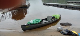

Dutchlennart Thanks for posting your pictures. I have a NEXT canoe but only use it for tripping on lakes. My wife worries a lot about my solo trips and the canoe tipping over. I'm always telling her how well my canoe handles wind and big rough water. I showed her your picture showing the NEXT over on its side. Nothing could show her better how stable the NEXT can be on lakes. Thanks again.

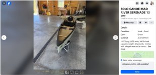

Never saw an aramid with gelcoat.
Maybe an injury or an upgrade or....
Not sure.if i bought ever a boat i did not like. Sold many of them as well due to injury, upgrades , change of interrest moving homes, shortage on cashflow..
Sometimes i think this is the boat to keep for decades. I think only the beercooler Made it over a decade. Scarborough conclusion....

I'm glad my post was helpful. I have very little to complain about my NEXT. I use my canoe for camping and carry a lot of gear About the only thing is I wish it was a little longer for more room. I usually take the seat out when I'm transporting the canoe to make it a little lighter.
At 77 years old I still have no problem loading the canoe on the SUV. Even with my health condition I have no problem getting in and out which can be a problem for older guys.
