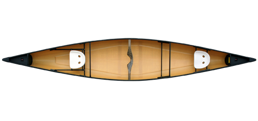

The Nighthawk Pegasus, a brand I'd never heard of, doesn't seem to have any significant tumblehome, as defined by chine width vs. gunwale width. The chine width isn't stated but seems to be about the same as the gunwale width of 36".
My educated guess is that the Pegasus has solid primary and secondary stability and would be very seaworthy. You won't be heeling a big canoe like this with three people in it, and I'm confident that you know that inexperienced paddlers (and even experienced paddlers) should not go out in big wind and waves, especially in the remote wilderness.
