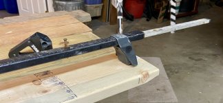

It was only nine years old, but the rear cross bar on my truck cap had become deformed, making some attachments difficult to fit. Some idiot had loaded boats on the bars by sliding them up from behind the truck. After a few hundred slides, hardware protruding above the gunwales had gouged the rubber coating, and then rust got busy. The bar was corroding inside the rubber, blistering and expanding the height and width of the bar.
This was one of those jobs that should take about 30 minutes, before Murphy visits. First, I couldn't figure out how to loosen the towers from the bar. Finally found a hidden tab that slides down to reveal Allen bolts that activate the bar gripper. But even after totally loosening the gripper, the towers would not budge. My choices seemed to be to remove the rubber coating and grind off the blisters of corrosion, or cut the bar. Either way, the bar wouldn't be much use. Successfully removing the bar took me a couple hours.
Thule-destr.jpeg - Click image for larger version  Name:	Thule-destr.jpeg Views:	0 Size:	321.6 KB ID:	113173
Now if I can just get that idiot to stop gouging the new bar with my dang boats...

The bar has been replaced. Fortunately, my kid moved out and left in the garage bars for a vehicle he no longer owns, so I liberated one of those. I cut a 2x4 to sit on top of the bar, and padded it with carpet, and it is very easy to slide a canoe onto it. The down side is that I no longer can attach the load stops, which I really like for longer, high-speed trips that inevitably include strong cross winds. I guess I can just lift up the canoe once it is loaded and remove the 2x4, but then I'm stuck carrying around the 2x4--not that big of a deal.
Mike, near as I can figure, I have towers that are THTB60 per Leer, or TB60 per Thule. I have never removed the racks prior to replacing the bar. They are incredibly easy to remove, like one minute per bar. I'm a little concerned how easily they come off, because I frequently hang my cap from a pulley system that connects to the bars. But, I guess if I can't hang the cap like that, I have no business strapping a canoe on the bars and driving around at 70mph.
The photo also shows, in the lower left, the front tower and bar end. At the end of the tube you can see about an inch of an aluminum, rectangular tube that telescopes within the Thule bar. Just inside the tower you can see a pin hanging down. The pin goes through the bar and the tube so the tube doesn't come out. There's a second hole through the bar near the tip. To extend the bar, remove the pin, pull out the tube, and reinsert the pin through the hole at the tip of the bar. My height puts my forehead at the perfect height for bashing on long bars, so I like to telescope the tubes back inside the bars whenever they are not in use.
I'm undecided whether to reinstall the tubes into the replacement bar. These days I do fewer trips with shuttles, and those are the trips where it is most beneficial to be able to carry two or more boats. But, drilling holes in the bars opens the way for water and rust. An alternative is to make two 80" 2x4s to sit on top of the Thule bars, and just plop those on if I need to carry more canoes. But, then I have to carry the 2x4's around. As I write, it dawns on me that I should just drill the Thule bars. If I get another nine years of rusting time, what's the likelihood that I'll still have the truck and still be dragging canoes around in 2030?
