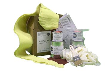

or you applay a skid-plate:

As a final step if it ends up messy, you can cover up the entire stem with a composite skid plate of either S glass or Dynel, and then paint the skid plate. There are several threads here about installing skid plates.
