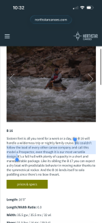

That's why I appreciate that Northstar doesn't call any of their models a Prospector. They realize how muddy the definition has become.
I think Northstar deliberately divorced from the label to make the point that they avoided the most negative aspect of the usual Prospector design - those sails at each end.
I love Northstar boats. If a could buy a new one it would be the Phoenix. You could easily slap the Prospector name on the B16 or B17, but I agree that it is good that they didn't.
