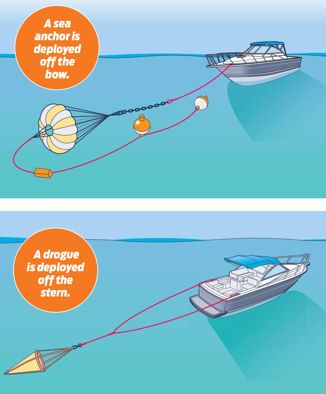

Or maybe dragging something like drogue chute would keep the canoe straight.
In the past, I've been successful in slowing the drift (for fishing) by dragging a heavy length of chain behind the boat but you'll have to paddle upstream whenever it gets snagged.
I use a panic snap within easy reach at the canoe and I have a float on the rope so the chain can be recovered in the event that it needs to be cut loose in a dicey situation.
The only way I can think of to decrease squirliness is to increase the load. Can you overfeed yourself or the dog? Maybe take a bunch of beer? (wait... beer might actually INCREASE squirliness depending on consumption levels.)
For fishing in the canoe you have to let the wind and current dictate how and where you will fish, don't fight it. I mostly fish flat water so wind is the challenge. Knowing which way the wind is blowing and how your canoe will weathervane, you can set yourself up for a drift that will hopefully take you over some fish. In a current you would have to do the same thing except it's more complicated because there is usually also wind. In general though the current will want to push the heavy end of the boat downstream so pointing your bow upstream and drifting backwards might be a solution. You could also adjust your trim to be either bow heavy or at least very flat, I would do this with my body weight by moving forward and back as conditions require. When I'm fishing in an empty canoe I can be anywhere from sitting in the stern seat to kneeling or sitting on the center thwart. I also stand anywhere in the boat I need to for the desired trim.
I've been thinking about the physics of a drogue or drift sock in river current. Unless it is heavily weighted like Gamma's chain, I'm not sure it would actually provide drag. It might just float along in the current at the same speed as the canoe.
The following video shows how a motor boat fisherman uses a Cabela's drift sock in a slow and deep river current. He bottom anchors the boat at the upstream end and then deploys the drift sock at the downstream end to to provide constant tension on the anchor line, thereby stabilizing the boat against current and wind swirls.
By the way, you can DIY a drogue by punching holes in a cheap five gallon bucket.
