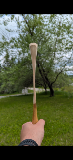

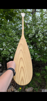

I've changed my opinion on what constitutes a Maine Guide Paddle. I got back in town about a month ago and measured the blade on mine. I stated earlier in this thread that it was 8.5 inches wide but was mistaken, it is only 7.5", but 32" long. I took it out on my first paddle after getting to the lake. I bring it as a backup paddle to mostly use when needed for specific situations.
I hadn't used it in since last season and was curious if it would paddle as nice as I remembered. Sometimes when you step away from something for a while your opinion changes about it. My opinion hadn't changed, I still loved it and used it for most of the paddle. It was an evening/night paddle with no wind on smooth water and it moved the boat along with slow easy strokes. The next morning I took it out in a little wind for a not so leisurely paddle and quickly switched back to my shorter paddle. This isn't the paddle for making time, unless you are strong enough for it, and I'm not.
Over the course of the next couple weeks I had taken out friends to fish a few times. One time I had two non paddling friends in the boat. I realized that the long paddle with the big blade not only made it easy to maneuver the boat, but it did it in a very smooth manner. It was perfect for this application, which I imagine was a big part of the Maine Guides repetoire.
So my definition of what the MGP is has changed. Now it is obvious to me that it doesn't have to be 8.5 inches wide. I do think that it has to be a beaver tail, for tradition sake. I also think there needs to be some combination of blade size and total length the enables it to "do more" then a standard beavertail at a comfortable paddling length.IMG_5016.jpeg
It's actually a great paddle for slow easy cruising with a slow cadence. It's also great when you need to turn your boat around into the wind and keep it there, especially from the stern seat or even the bow seat facing backwards. I don't stand much anymore, but a long (MGP) is always with me. This 6 footer weighs 34.85 ounces with a 32" X 7.5" blade. This one is so light feeling (I mentioned earlier that it feels hollow) and bouyant that it takes energy to hold it down doing underwater recoveries. My ash ones have a more nuetral bouyancy for under water recoveries. One weighs 38.55 ounces and the other is 40.53. They are both six feet with blades 30.5" X 6.125"

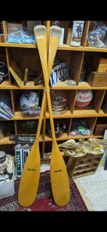

Many so called guide paddles are not a lot of fun to put to use in my own experience. One of the worst offenders by far was a Shaw and Tenney Maine Guide I found at an antique store. The blade was heavy and thick, the shaft oversized and the grip designed similarly. I've seen some with 10" wide and 30"+ long blades that swing like a ball and chain rather than a well balanced tool for maneuvering a canoe. However within this design niche I have found several examples that defy expectations. Specifically paddles made by a man named Ray Porter.
He was a world war 2 veteran, bush pilot, guide and wood worker. For many years Porter's wood working made many of the paddles sold by Old Town back in the day. What I have found with these paddles is that they are refined and thinned in ways that many other guide paddles are not.
The blade and shaft are carefully balanced, he seemed to only pick the straightest grained boards and thinned his paddles to the practical limits of the materials and their eventual use by knowledgeable canoeists. These are not heavy sticks to bear against the rocks but works of practical art by comparison to some examples. I spent a lot of time handling them but didn't have the privilege of paddling a canoe with one. The paddle grip flexes slightly under a load and springs back readily, the blade is wide and thin allowing quiet and smooth in water recovery and the tip is slightly; not dramatically thicker at the end
I did not end up buying any of these paddles when I saw them come up for sale and do regret it a bit in retrospect. However I have been greatly inspired by their form and hope to remember the qualities that made these so special when I go to create my own paddles.
This particular specimen is 60 in long with a 7" wide blade. The balance is right where the shaft begins to transfer the throat, it doesn't favor left or right in the water and cuts quietly through during in water recovery. Not my first pick for whitewater, or pushing off of rocks but a good all round cruiser. The edges of the blade taper to about 3/32" and the very tip is around 1/4". My woodworking skills are amateur at best so my lines were not as accurate as would be required to thin this paddle out more. A far cry from Porter's work but the same principles are on display in this creation I like to think.

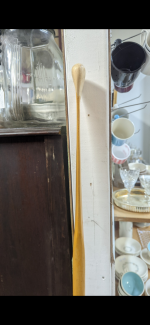

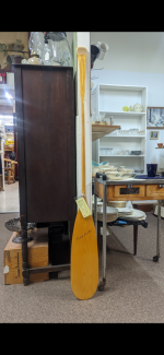

Last but not least a 73" maple behemoth with no maker's mark. It is only slightly blade heavy which is remarkable being that it has a 8 1/4" x 30 blade, the edges are around 3/32". It's too long to use under most circumstances, but I'm sure would make a great steering paddle for a war canoe.

That maple paddle sure looks nice, is it yours?
It sure is, it was right next to the Shaw and Tenney Maine Guide at the antique store. I don't use it much, but imagine one day I'll bring it along when I have a big square stern in my fleet one day.
