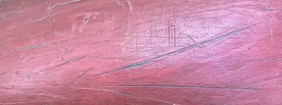

I recently purchased a used canoe and need to make a few repairs but I have NO idea what material was used in the construction. (Is this Royalex?)
I am hoping someone can help me out!
This canoe was a rental from the Shenandoah River Company and in the past they would build their own canoes so it is not a standard manufacturer.
Questions are:
1. Based on the cross section of the material in the pictures, can you tell what material it is built from?
2. Are the gouges deep enough to worry about as some appear to reach the second level of material?
3. What are the different repair methods I could utilize (heat / Urethane compound / Wax)
4. As you can see, I need to replace the decks. What would be my best option? (Build / purchase a few and try to fit them)

Looks like Royalex to me. If those scratched you show are the worst of them, I wouldn't worry about it, that's pretty standard for royalex. I'm not sure about decks, if you wanted to class it up a little, you could replace all the gunwales and decks with wood. If not, there are plastic decls out there made for specific canoes that might fit.
Even if the scratches are through the vinyl and into the pvc?
Should I fill them with West System 655 to make sure the damage doesn't get worse?
I am wondering if I should just make the decks from fiberglass as opposed to trying to find decks that would match.
I wish I knew who made the hull.
I've made glass decks several times for old canoes needing some lovin'. A lot of those boats are out of production, so making your own is easier and cheaper than trying to find replacements.
It's actually very easy- tape some cellophane over the hull, extending past the bottom of the new deck. add a few layers of painters tape along what will be the ends of the cap (leaves a mark to grind to) glass the crap outa' it (I just use scrap cloth or matting) and layer another piece of cellophane over it and tape it down tight. next day pull the whole mess off, remove the cellophane and tape, grind to the marks, drill mounting and drainholes and you're done, the layers of cellophane should ensure a textured but smooth finish so the only sanding needed is along the trimmed edges and the drain hole.
you can even mix dye in for custom colouring

In that regard be very careful with acetone or any solvents around the scraped vinyl skin showing black underneath. That black is the ABS layers between the vinyl skin and foam core; solvents can eat/dissolve that ABS layer, and penetrate into the foam core
Interesting to note how thick that black ABS layer is, on both sides of the foam core. On more modern Royalex boats the ABS layers are much thinner for weight savings, and the ABS layer under the vinyl skin on the inside of the hull thinner still.

Those are some pretty modest scratches for a royalex boat, even a newer, thinner one. If it were mine, I'd revarnish the seats and get on the water.
The foam core exposed under the missing decks is not a concern for rot -- people usually leave the top of the hull open when they do wood gunwales and nothing bad happens (except cold cracks, but that's a different issue!).

I’m with Memaquay and Goonstroke, I wouldn’t do much to it, especially before you know if the gunwales are still sound.
If some of the very deep scratches bother you maybe fill them with G/flex. If the stems are significantly worn, especially if the wear is through the vinyl and ABS layer and into the foam core, I’d install Dynel skid plates. If the Shenandoah has old worn/cracked skid plates you can add a layer of abrasion resistant Dynel over them after filling/repairing any cracks or voids.
https://www.canoetripping.net/forums...-and-retrofits
The vinyl skin is there mostly for UV protection, and so the hulls were not ABS black. If the aesthetics of the of the scratched up bottom really bother you maybe tape off the gunwales and paint the hull or, easier, tape off a scuff line half way up the canoe and just paint the bottom. Any paint you use, even pricey epoxy paint, will scrape off on low water rocks, so it is best to use a paint color that is close to the hull color.
