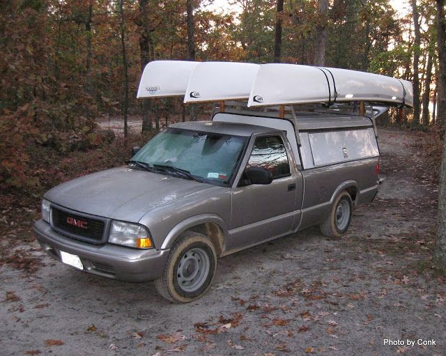

Here, via Conk's photography, is a unique picture of my white SRT along with Conk's and Harold's in the Jersey Pine Barrens.
