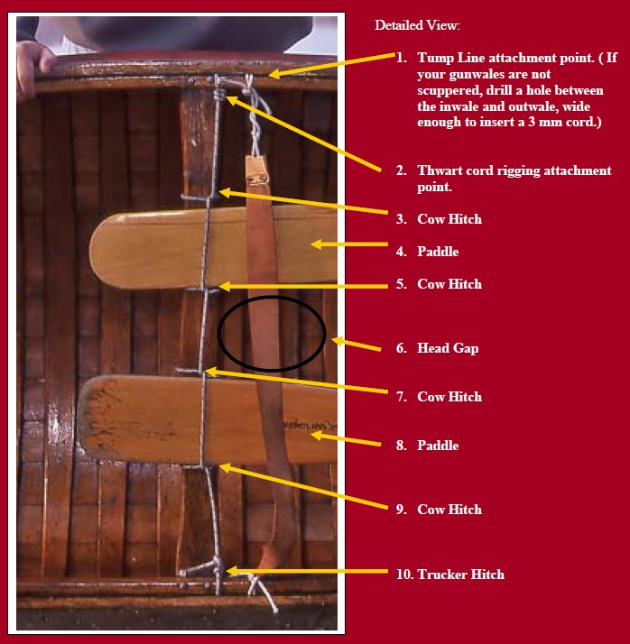

Of course, there has to be some common sense with its usage. I might slip it off if portaging on very unsure terrain like slippery mud or wet rocks. After trying various configurations with lashed paddles, I now use a method illustrated in Robert Ritzenthaler's Building the Chippewa Canoe. Here the native builder, Bob Pine, puts his paddle blades forward and uses the tails of the tump to secure the paddle grips onto the center thwart / yoke.
The blade forward position makes the bow a bit heavy, but this is offset with the fact that I lash my kneeling pad and some other stuff to the seat in the rear and that creates the necessary balance. Here's a pic of everything lashed up.

"In packing a canoe, the best canoe-carriers of the Manicouagan and the Moisie Rivers just cross the paddles and tie them on top of the front bar. They then pass the tumpline over the blades at the middle bar. To judge the distance from the bottom of the canoe to the tumpline they measure a handspread upright."
Lastly, here's a link (*.pdf format) showing an alternate method which uses a combination cord and leather tump line. It's from Camp Nominingue in Quebec

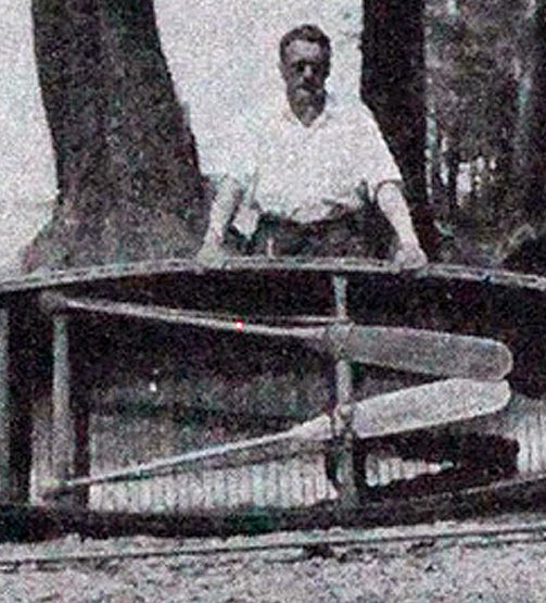

A similar technique appears in the April 1930 edition of Field and Stream (Vol. 34 No. 12). The article is entitled "Carrying a Canoe" by Richard Garwood Lewis. In one of his photos, you can see the paddles rigged out in a flared manner (providing more headroom than Rutstrum's illustration) with the tumpline straps extending along the shafts to the lashed grips
Here's a closeup...
The scout troop I was a leader in for years used a system using paddles very much like the pictures. Wearing a keyhole PFD for padding,this is quite comfortable. When I was younger I carried a 17' Grumman for miles this way without a tump. Arms extended to the front thwart held the canoe foreword.

I don't know what kind of canoe that is, but the center thwart is too far back for using it to carry the canoe. Using those paddles like that was probably the only way to carry it without using a detachable carry thwart. I wonder if it was built that way just for that purpose, making the thwart a little off center would place the paddles in the exact spot to carry the canoe. That to me says these folks where really set on using that system to carry the canoe, sort of practicing what they preach. Nice.

Robin, you know your stuff, I don't think I would have made that conclusion.... Other than the center thwart not being in the centre....
Ha, Thanks Canotrouge but I was looking at the canoe in the picture and I thought it looked like a Chestnut Bobs, I guess that was wishful thinking or my weird attraction to Chestnuts cause it doesn't look like a Bobs at all, it has two thwarts first off. So, I'm looking at those thwarts and that's where I came to that conclusion. I could be way off, but Thanks for the "atta boy", I'll take it...haha

Good eye, Robin. I never noticed the thwart placement untill you mentioned it. Sort of recall reading in one of the Wooden Canoe journals that by the 1930s, a lot of used livery courting canoes were being sold off as the canoeing "fad" was slowing down. Many trippers then starting using these canoes for their adventures. These boats usually had no center thwarts but had one oddly placed behind the bow seat so that the passenger could lean back on a slatted canoe rest facing the stern paddler. The other was off center towards the stern giving more useable space. This tump and paddle rig looks like a practical solution to the thwart placement.
I think one of the features of early Morris canoes was a removable center thwart to aid with carrying and these days finding a Morris with an original center thwart is pretty rare. Maybe Mihun could chime in. Here's a pic of a Morris from its wikipedia page. The angle of photo isn't the best but it seems to a have a similar thwart placement to the old photo.

I think the canoe in the picture is about 15-16' long... as such, perhaps a center thwart is 'too many'? Neither my uncle's 15' Old Town 50 Pounder nor my own 16' OT Yankee have "center" thwarts and can only be portaged with a separate, removable yoke, or by lashing the paddles on as shown. When I'm out solo with a double paddle and no spare, I use a 6' pole for the other side. Works well. Have yet to use a tumpline though. Making one out of some seat belt webbing is a winter project this year.
