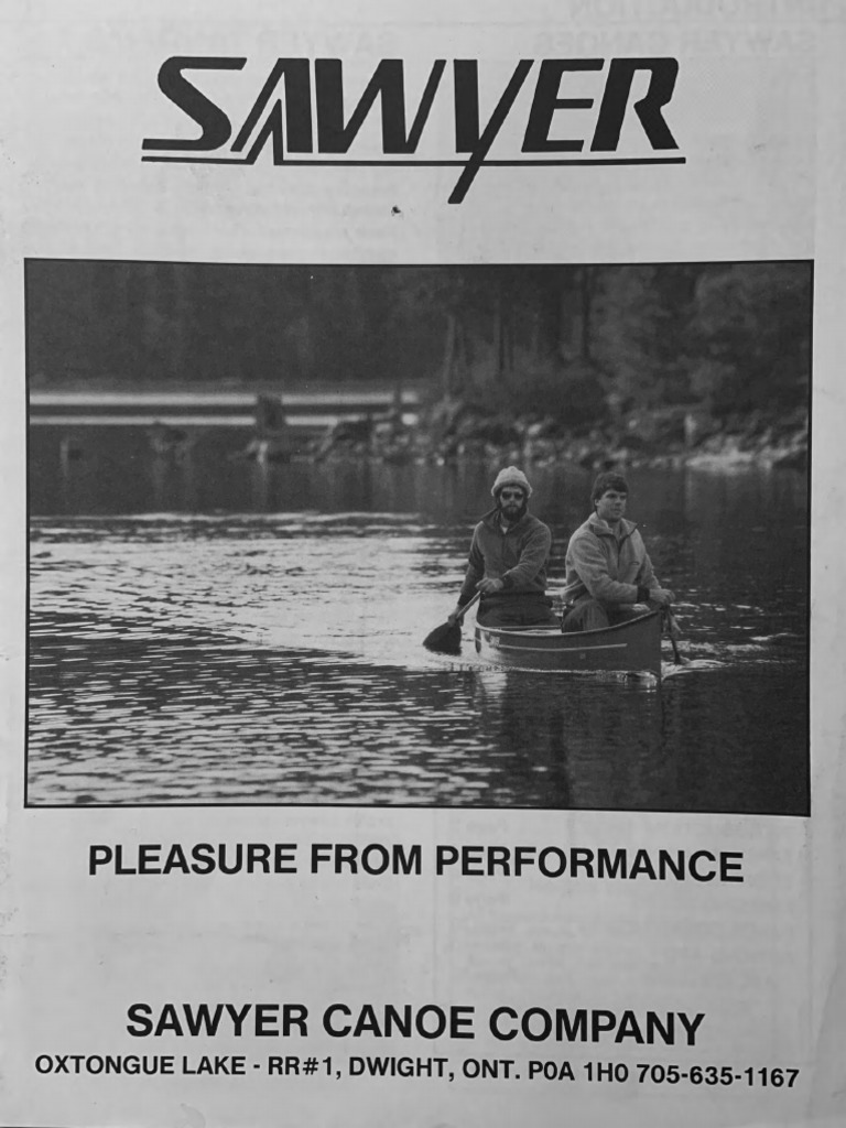

• Happy National Limerick Day! 🅰️🅰️🅱️🅱️🅰️
1983 Sawyer Kevlar interior color?
Jun 15, 2022
239
315
Spartanburg, SC
Perhaps some of you who have or have had an early 1980's Sawyer Kevlar canoe could answer a question for me:
Was the interior of the Sawyer Kevlar canoes, especially a DY Special in Expedition Kevlar, left in a clearcoat or painted? If painted, do you know what color?
I have a 1983 DY Special that has a yellow paint, similar to the color of Kevlar, that is starting to flake off. It makes sense to me that a paint would help protect the Kevlar from UV rays, but my other Kevlar canoes are clear-coated on the interior. I am wondering if the paint was factory done or if an owner did it. It is a very nice job if done later and the Kevlar under the paint looks new with no sign of UV or other damage.
If you have any info on this, I would love to hear from you and find an answer my question. Thanks!
Page 10 of this 1988 Sawyer catalog says that "Expedition Kevlar canoes are finished with a full interior gel-coat to prevent decomposition of the laminate due to exposure to sunlight."
Mike Galt used to gelcoat the interior of some of his Lotus canoes. That's a much more difficult, expensive and probably durable process than paint. It might be hard to match with a paint. I don't really know.
There are other Sawyer catalog pages you can scrutinize for info HERE.
Thanks for the great info on the Sawyer line-up! That is quite a resource.
From the looks of it, the DY Special originally came with a gel coat on the interior, so I now assume that some previous owner painted the interior. Where the paint has peeled the gel coat looks great. I had been debating repainting the insides, but now I am thinking about paint removal.
Any suggestions on safely removing an unknown paint (oil based? Latex? other?) from a gel coated surface?
Thanks for the great info on the Sawyer line-up! That is quite a resource.
From the looks of it, the DY Special originally came with a gel coat on the interior, so I now assume that some previous owner painted the interior. Where the paint has peeled the gel coat looks great. I had been debating repainting the insides, but now I am thinking about paint removal.
Any suggestions on safely removing an unknown paint (oil based? Latex? other?) from a gel coated surface?
I don't have any knowledge or experience with removing paint from a canoe, but are you sure the yellow coating is actually paint and not the factory gelcoat itself? They may have used a yellow colored gelcoat and not clear gelcoat, possibly per the customer's instructions.
It's just not clear to me why someone would paint the interior of a canoe that already has a fully gelcoated interior, which is a pretty rare thing, unless the interior gelcoat was extremely scuffed up and damaged.
Pretty sure it is paint. I can peel some off and it is flexible, not stiff or brittle.
  • DSCN0804.JPG
    46.7 KB · Views: 4
  • DSCN0800.JPG
    71.8 KB · Views: 4
